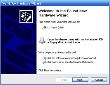

    1. On the New Hardware Wizard prompt, select Install from a list or specific location (Advanced) and click the Next > button.
Windows XP - New Hardware Wizard

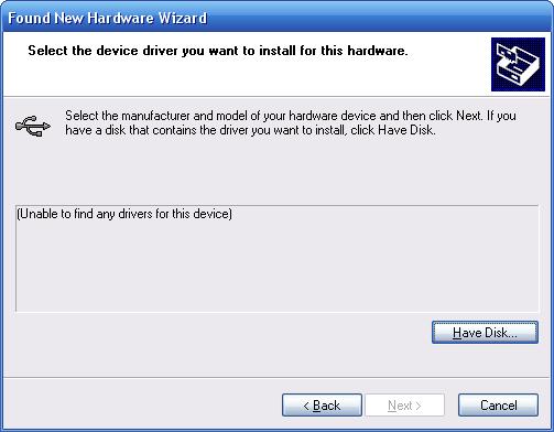

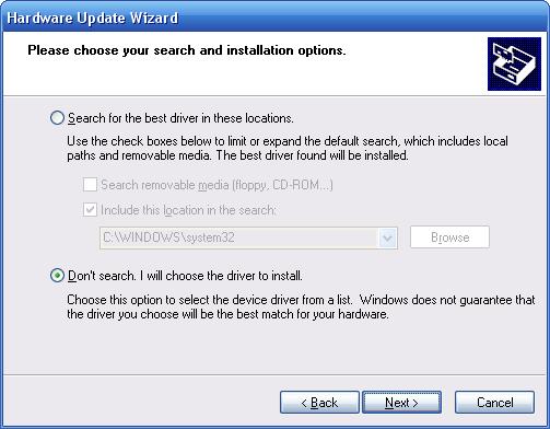

    1. Next, select Don't search. I will choose the driver to install and click the Next > button.
Windows XP - Choose Driver to Install
    1. Next, click the Have Disk... button.
Windows XP - Have Disk

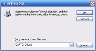

    1. On the prompt that appears, click the Browse... button to navigate to the directory where the FTDI drivers were extracted, then click OK.
Windows XP - Driver Search Location

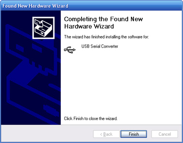

    1. After the USB driver for the programmer/debugger has been installed, click the Finish button to complete installation.
Windows XP - Installation Complete

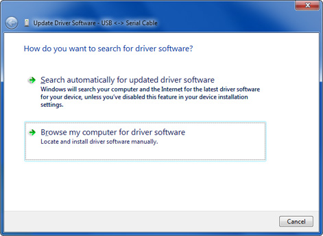

    1. On the New Hardware Wizard prompt, select Browse my computer for driver software.
Windows 7 - New Hardware Wizard

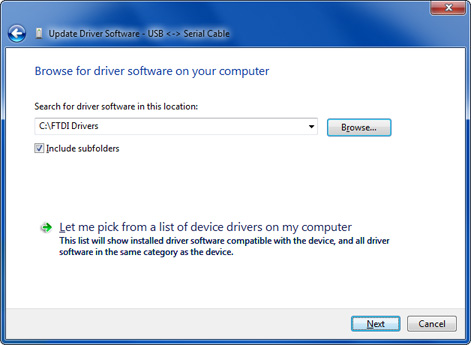

    1. Next, click the Browse... button to navigate to the directory where the FTDI drivers were extracted. Make sure the Include subfolders option is checked, then click Next.
Windows 7 - Driver Search Location

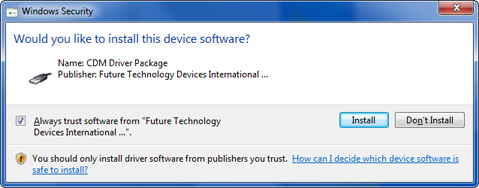

    1. A prompt may appear asking if the driver should be installed even though the publisher is not trusted. Check the Always trust software from "Future Technology Devices International ..." and click Install.
Windows 7 - Security Warning

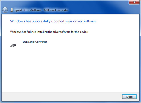

    1. After the FTDI driver for the programmer/debugger has been installed, click the Close button to complete installation.
Windows 7 - Installation Complete

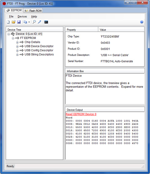

    1. Open the FT_PROG utility downloaded from FTDI's website.
FT_PROG

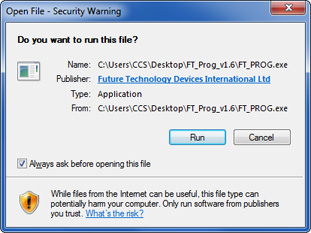

      • If using Windows Vista, 7, 8, 8.1, 10 or 11, a prompt may appear asking if the utility should be allowed to run. Click the Run button.
FT_PROG - Security Warning
FT_PROG - Scan for Devices
    1. When the programmer/debugger appears in the left pane, it will be listed as a USB <-> Serial Cable under the main device heading. Right-click on the device heading and select Apply Template -> From File in the pop-up menu.
    2. Select the .XML file for the connected programmer/debugger. A prompt should appear stating The template was successfully applied, then click OK.
FT_PROG - Template Applied
    1. After the .XML file is loaded, select Devices -> Program from the menu bar along the top.
    2. In the window that appears, click Program to program the FTDI chip inside the programmer/debugger. After Finished Programming is displayed in the lower left corner of the window, click Close.
FT_PROG - Device Reprogrammed
