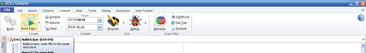

- Click on BUILD AND RUN on the compile ribbon.
- If the program is correct, after being compiled, compile screen will show "No Errors".
