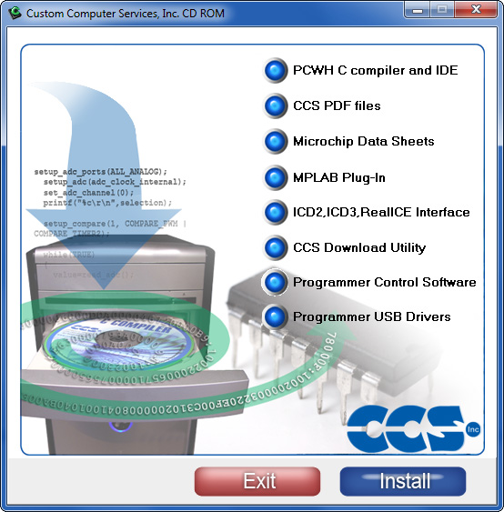

      1. Insert the CD-ROM into the CD drive. Once the CD-ROM is loaded, an auto-run menu will appear.
      2. Make sure the circle next to Programmer USB Drivers is blue and click the Install button.
      3. If the CD-ROM does not auto-run, the USB driver setup can be started by double-clicking the CD drive in My Computer and double-clicking the setup executable in the USB-Driver folder.
CD Auto-Run Menu

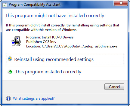

    • If using Windows Vista, 7, 8, 8.1, 10 or 11, after the USB driver installation has completed, a prompt may appear stating that the program may have been installed incorrectly. Click the Reinstall using recommended settings option to re-run the USB driver installer. Repeat steps 1 - 4 to ensure the USB drivers are installed correctly.

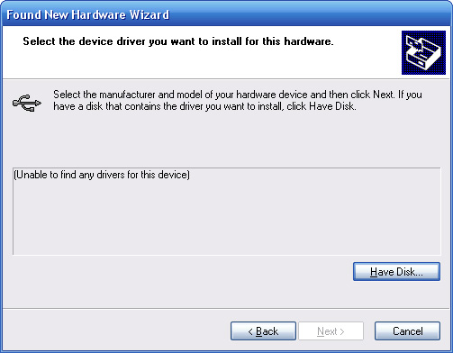

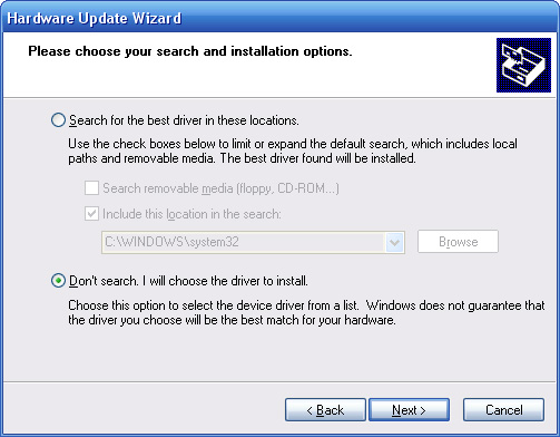

    1. Next, select Don't search. I will choose the driver to install and click the Next > button.
Windows XP - Location to Look for Driver

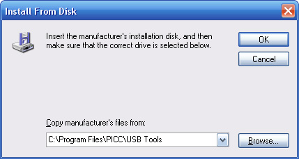

    1. On the prompt that appears, click the Browse... button to navigate to the directory where the USB drivers were installed, then click OK.
Windows XP - Location to Search for Driver to Install

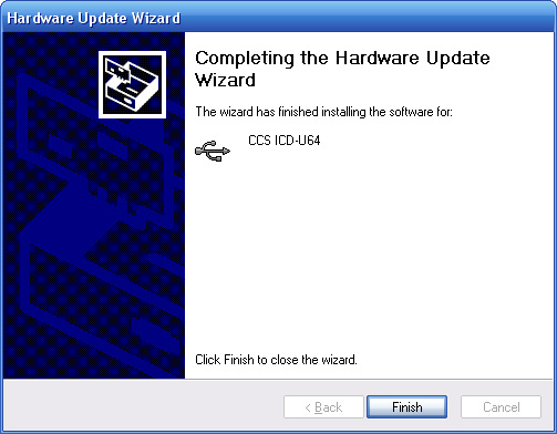

    1. After the USB driver for the programmer/debugger has been associated, click the Finish button to complete installation.
Windows XP - Installation Complete

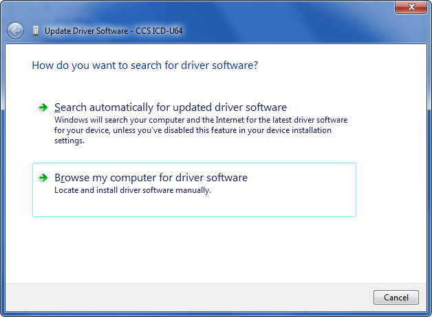

    1. On the New Hardware Wizard prompt, select Browse my computer for driver software.
Windows 7 - New Hardware Wizard

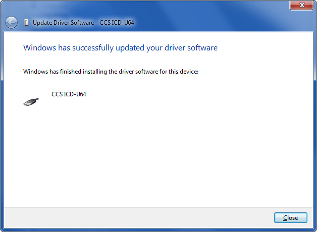

    1. After the USB driver for the programmer/debugger has been associated, click the Close button to complete installation.
Windows 7 - Installation Complete

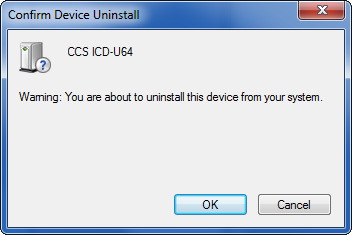

    1. If the programmer/debugger appears in the list under Other Devices, right-click on the programmer/debugger and click Uninstall in the pop-up menu. A prompt will appear asking to confirm device uninstall; click the OK button. If given the option, check the Delete the driver software for this device box.
