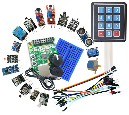

The processors used in this machine were all easy-to-use CCS E3mini boards that have a PIC® processor programmable from a USB port.
The various sensors that were used for this project are shown in the diagram above and are listed in order below.
- Sound
 - Tilt
 - Magnetic
 - Sonic
 - Temperature
 - Vibration
 - Light
These sensors and more are available in the Sensors Explorer Kit.
