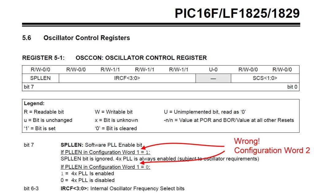

Any by the way, Microchip does mistake too, even in datasheet. It should be written Configuration Word 2 and not 1:
You started to bring some light in here, but I should take it slowly.

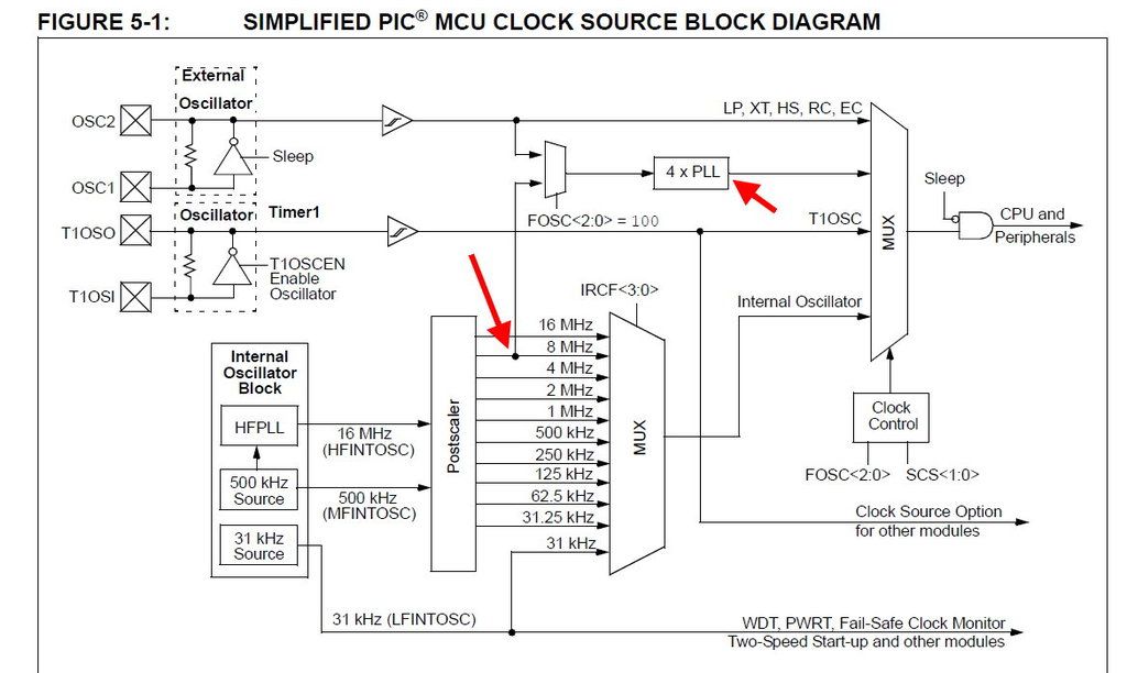

After reset the PIC wakes up with 500KHz default internal frequency, meaning internal oscillator.
If I want 32MHz, then I must set explicitly in software the value of OSCCON register to 8MHz and to enable the PLL.

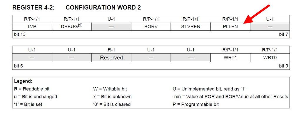

We have 2bits for PLL in datasheet, one is PLLEN in Configuration Word 2 and then we have SPLLEN in OSCCON register.
The fuses (Configuration Word 1 and 2) are set first, in the beginning and then the OSCCON register comes later in code, either main or a header file.
Is that right?

But if I understand right the datasheet, it’s a big book 420 pages : ), it says:
Quote:
“The SPLLEN bit in the OSCCON register must be
set to enable the 4xPLL, or the PLLEN bit of the
Configuration Word 2 must be programmed to a
‘1’.”
So is one or another. I have 2 options. And CCS force the situation to always SPLLEN by keeping PLLEN always 0.
I do not want that. I want PLLEN=1 and forget about SPLLEN in OSSCON.
Is nothing wrong in the end, because both options are valid according with the datasheet, but why did the cut access to PLLEN bit in CONFIG2 (PLL bit CCS in #fuses)?

It was obviously from beginning, also seen in XC8 code, that I set the internal clock to 8MHz in order to get 32MHz.
Then there is that note:
Quote:
“Note: When using the PLLEN bit of the
Configuration Word 2, the 4xPLL cannot
be disabled by software and the 8 MHz
HFINTOSC option will no longer be
available.”
Which implies that PLLEN in Configuration Word 2 has priority (if set in fuses) over SPLLEN (equivalent of PLL_SW in CCS) on OSCCON.

You mentioned couple of times that I can set the fuses explicitly, but actually “PCM programmer” already tried that on the previous page with a code as below and does not work.
#include <16F1825.h>
#fuses 1=0x07A4
#fuses 2=0x1DFF
#use delay(clock=32M)
while(TRUE);
Let’s assume, as in my case, that I want to use the internal clock at 32MHz.
If I read the datasheet and I go step by step through all the fuses settings, then I do it as in XC8:
1) I set PLLEN in Configuration Word 2 and later in code I ignore the SPLLEN in OSCCON and I set the OSCCON to have 8MHz, which will produce 32MHz due to PLLEN.
2) CCS does it different.
No matter if you use PLL or PLL_SW in #fuses, as long as you set “#use delay(clock=32M)” automatically sets the PLLEN to 0 and uses always PLL_SW by setting SPLLEN 1 in OSCCON.
I am not saying that is necessarily wrong as long as the chip works fine and we get the 32MHz, but it makes you wonder why it is the PLL bit in #fuses still available if it is kept 0 always anyway.
And that makes you wonder further: why not when I say/set PLL, then automatically the clock to be set 32M or the other way around, when I say 32M to have the PLL set, so all automatically to the end. But I am sure it would be a compatibility problem with other chips inside the compiler which must have broader setting options.
Why is like that? Obviously due to some internal CCS compiler settings, either wanting to keep compatibility with other chip families or wanting to reduce the possible user error settings or they cannot do it other way.
