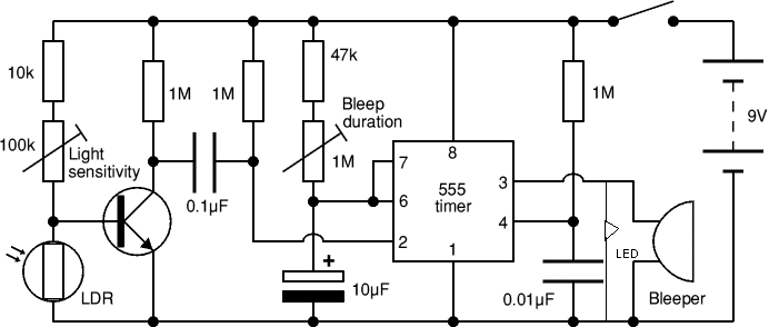

This code I want to use for ldr that connect to pic pin_a0. I assume initial intensity light 1volt, suddenly intensity light change to 2volt. Led light 1minute. So 2volt will be current ref intensity. It always change. This project for movement detector. This using ne555 but I want using pic for more efficient.
http://www.electro-tech-online.com/attachments/general-electronics-chat/22685d1222869801-triggering-555-timer-ldr-circuit-2.gif

Due to natural noise the value from the A/D will always be different. You need to decide on a threshold where the light level is "significantly" different. Subtract the new light level from the old light level. If the difference is small, positive or negative, then the light did not change significantly. If the difference is bigger then you trigger your LED.
Note that artificial lights tend to flicker at 50Hz or 60Hz depending on where you are. You may have to find a way to ignore this flicker.
