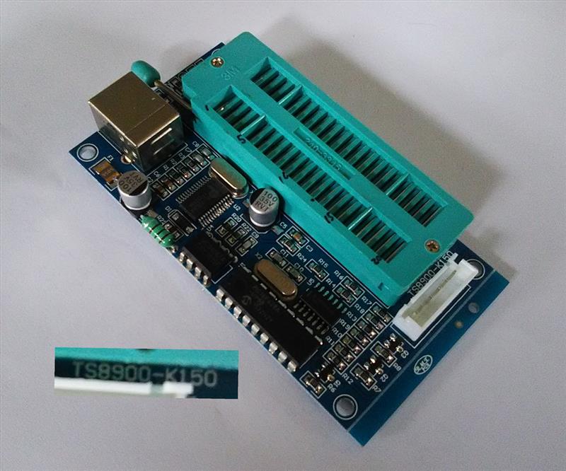

PICK 150 for PIC Programing
[img]
https://cdn.snsimg.carview.co.jp/minkara/parts/000/009/261/626/9261626/p1.jpg?ct=bf743b426496
[/img]
And for the PIC powering TS8900-PIC:
[img]
https://ae01.alicdn.com/kf/H1c4cee47902040a5be57a7b12708ee7fD.jpg
[/img]
So this every major thing I been using in this project
