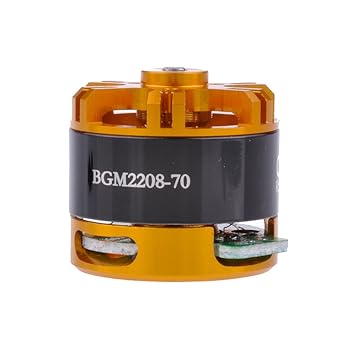

BGM2208--70
Item no.: BGM2208-70
12N14P
Wire: 0.15mm
Turn: 70 T
Motor size: Ф28*26
Shaft: Ф3.17
Ω Ri :13.30ohm
Weight: 40g

PostPosted: Tue Jan 26, 2016 2:26 am     Reply with quote
The first thing is that you don't want three phase the way you show it.....
BLDC motors like this have forward and reverse drive on each coil. The sequence is:
Phase     coil A    coil B    coil C
1           +          -          0
2           0           -         +
3           -           0         +
4           -           +         0
5           0          +          -
6           +          0          -
If fact for smooth motion, the '+' energisation (for example), wants to be a synthesised sinusoidal waveform, so a much higher frequency PWM, varying from almost nothing to full power and then back down to almost nothing over the cycle. When the motor is stationary, the current PWM ratio on the correct pins has to continue. Two coils active at any one time.
You need six FET drivers, three energising the coils in a positive direction, and three in a -ve direction. A total of six control pins on the PIC.
For the slow speeds that the gimbal will actually rotate, you may well be able to run without BEMF sensing, and instead treat all motions as if they are initial 'start' operations. AN857, does show how to generate these waveforms from just about any PIC.
