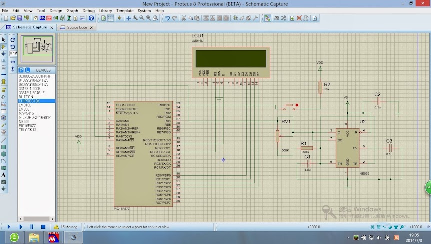

Thank you very much, I know there are many advantage with my
PostPosted: Thu Jul 03, 2014 3:18 am     Reply with quote
Thank you very much, I know there are many disadvantage with my program.
I have correct them but it still doesn't change what LCD display. Crying or Very sad
LCD keep displaying "Vacant" whatever i do.....
I'll go try built it in real.
Please help me, experienced programmers
I'm just a poor student try to complete my work Crying or Very sad

PostPosted: Thu Jul 03, 2014 4:50 am     Reply with quote
Thank you very much for rewrite the code for me. However it's still troubling with just display "Vacant car".
Seems the #int_ext still don't work.
Do you have any idea,I'm sure my simulation circuit is right.

Ttelmah wrote:
As I said:
"Then the button input, and (possibly) the odometer pulse (if this is what it is), will need pull-up resistors."
A button on it's own, won't generate a signal the PIC can see.
Probably it's my circuit that's wrong,would you please have a look on my simulation circuit?

Think.
You are programming the interrupt to trigger when the pin goes high to low.
The pin needs to be pulled _high_ when the button is not pressed, and then pulled _low_ by the button.
So the standard circuit is a resistor from the pin to Vdd, and then the button from the pin to Vss. This way, when the button is pressed, the pin goes low.
Posts: 9658
PostPosted: Thu Jul 03, 2014 10:48 am     Reply with quote
also you'll probably need to add a small 'filter' cap across the switch contacts to minimize the 'bounce' or you'll get multiple inputs!
hth

This is a schematic of how you should connect the pushbutton, per
Ttelmah's description:
          +5v
            > 4.7K
            <         ___  Switch
To          |        _|_|_
PIC -----------------o   o------
pin                            |
B0                            --- GND
HWGonly1

Thank you very much, I've already solved my problem!Thanks!!
PostPosted: Thu Jul 03, 2014 8:33 pm     Reply with quote
Ttelmah wrote:
Think.
If you didn't help me,I haven't realize something wrong with my circuit,thank u!
pin                            |
B0                            --- GND
