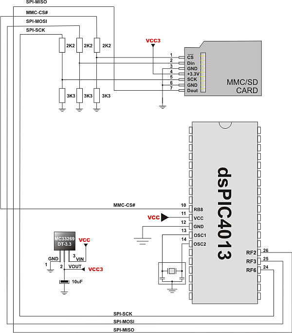

Please look at newly added schematics, they all work without IC. |

The first three implementation are operating outside of the manufacturers guaranteed performance envelop of the PIC. Just like overclocking a CPU. They may work today, they may work for 20 year and they may fail tomorrow. This type of implementation is fine for hobbyists. For an engineer to implement such a solution is either lazy (did not read the data sheet), illiterate (could not read the data sheet) or incompetent. _________________ Regards, Andrew

When I have pull-up resistor to 5V on the DO(7) pin of SD card, isn't it called a kind of level translation?
Here is my part of schematic:
http://imageshack.us/photo/my-images/62/sdsch.png/
I use LM1117-3.3V for 3.3V supply. |

No..it's a pullup resistor ! It puts +5volt on everything connected to it,in the 'idle' state. Which means it'll put +5 volts INTO the SD card, NOT good as it'll destroy the card or at the very least 'weaken' it so it will fail.
As we've already said several times you MUST use proper level translator IC. It will take the SD cards logic high of 3.2 volts and convert it to a PIC acceptable 4.8 volts. Going the 'other way' it will convert the PICs +5 outputs to +3.2 volts for the SD card.
Before you blow up anymore SD cards, just breadboard the resistors and see what voltages you get...compare to what is needed.

If you connected the DO output to +5v then you may have killed the card. In this case you will not receive anything.
Check out the projects page on my site, you will find reference examples for implementing SC/MMC cards with 5 volt PICs.
The reason there were two pullup resistors is because the designer wanted to ensure the SD/MMC card was deselected if the output driving CS from the PIC was floating such is the case when a PIC is reset. The specific version of IC used in this example is important as not all versions of this chip are tolerant to +5 volt inputs including some of the implementations of the SD/MMC PICTail from Microchip. _________________ Regards, Andrew
