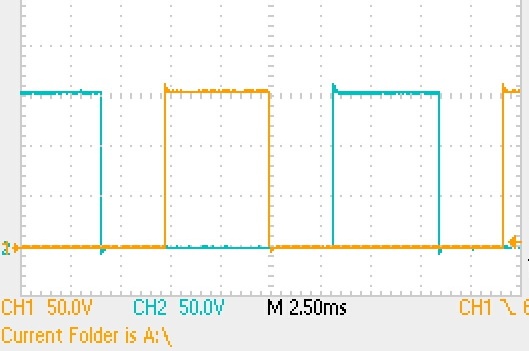

Folks,
I’d like to drive an H-bridge with 60Hz square waves with large dead time. This is for a DC to AC inverter.
I wonder. As long as PIC's clock is no faster than 13.1Mhz, it should be possible to generate such slow waveform with ECCP. Right Question

Well you don't say which PIC you're using....but it's a piece of cake to use the 16C84 to make a DC-AC invertor using the H-bridge topology at 60 Hz...

yea... 60hz is so slow (I just did something similar recently) -- that a simple timer ISR should do the trick.
