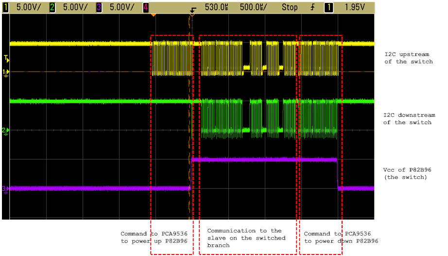

I’m writing code for both. There are also simple slave devices without firmware (I/O expanders). The challenge is that my bus is hot-pluggable. If a branch is plugged in (and I have to use a pretty bad connector) in the middle of a transaction it may mess-up the transaction and leave the slave device in a bad state.

| kender wrote: | | It looks like the P82B96 can be used as a bus switch, if it's Vcc is switched. |
This approach actually worked. I have an I/O expander in the same area, and I'm powering P82B96 from one of I/O expander's pins. Here's a scope screenshot.
