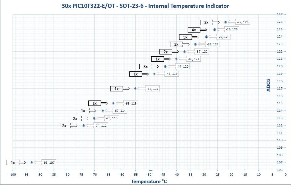

I tested 30 pieces PIC10F322 extended version (up to 125°C) in package SOT23-6 without calibration.
I had to change the offset in the code from 40 to 120 because the temperature readings were a lot under the expected negative values and were not sent correctly serial.
I used Microchip AC163020 programming adapter.
http://www.microchip.com/Developmenttools/ProductDetails.aspx?PartNO=AC163020
The test was quite fast, more difficult was to install and remove the PIC with the tweezers in the SOT23-6 socket.
I programmed each chip and in the next seconds I could see the ADCfvr, ADCti and Temperature on the display.
Here are the results:
https://docs.google.com/spreadsheets/d/1fKRiEQRW1PlvNmhArHVVosVSSOR7cu6wQtWIlS-2loM/edit?usp=sharing
The calculated temperature inside the PIC is close enough to the value calculated in Excel.
Here is graphic with the spread of the temperature measurements without calibration:
https://docs.google.com/spreadsheets/d/1fKRiEQRW1PlvNmhArHVVosVSSOR7cu6wQtWIlS-2loM/pubchart?oid=1237926541&format=interactive
http://i926.photobucket.com/albums/ad102/viki2000/Microchip/30x%20PIC10F322%20-%20Temperature%20Indicator_zpswymosuym.jpg
The FVR measurement used to calculate the VDD is very good and constant for all samples.
The temperature measurement without calibration is awful.
It shows differences of 50°C easy.
It make no sense to try it at different VDD voltages and different temperatures.
It would make sense such tests if we calibrate it at least in one point.

I repeated the test with the same code for PIC10F322, same setup, but this time using 30x PIC10F322 I/P industrial version up to 85°C and package PDIP-8.
The results are here:
https://docs.google.com/spreadsheets/d/1Sp4X8oMsgnUMJDDK9AYYJvSZA53hTQkXlefjshloK60/edit?usp=sharing
https://drive.google.com/open?id=0BwXmKaSw75eKT1ozMnJiLWdibUU
http://s926.photobucket.com/user/viki2000/media/PIC10F322_I_P_DIP8_Temperature_indicator_zpsp9iiwlcb.jpg.html
In my 1st case with SOT-23-6 PICs, the ADC result is between 107 and 126.
If we calculate back the junction voltage we get:
- for 107: (107*5/255)/4=0.5245, which gives (0.5245/0.5735-1)*100=-8.54% deviation compared with 1 device PIC16F1937 which has 0.5735V at 25°C
- for 126: (126*5/255)/4=0.6167, which gives (0.6167/0.5735-1)*100=+7.53% deviation compared with 1 device PIC16F1937 which has 0.5735V at 25°C
- The deviation of the junction voltage of the PIC10F322 SOT-23-6 compared with 1 device PIC16F1937 is then +7.5/-8.5%.
- The deviation range is +7.5%-(-8.5%)=7.5%+8.5%=16%
In my 2nd test with PDIP-8 PICs, the ADC result is between 120 and 140.
- for 120: (120*5/255)/4=0.5882, which gives (0.5882/0.5735-1)*100=+2.56% deviation compared with 1 device PIC16F1937 which has 0.5735V at 25°C
- for 140: (140*5/255)/4=0.6862, which gives (0.6862/0.5735-1)*100=+19.65% deviation compared with 1 device PIC16F1937 which has 0.5735V at 25°C
- The deviation of the junction voltage of the PIC10F322 PDIP-8 compared with 1 device PIC16F1937 is then +2.5/+19.6%.
- The deviation range is 19.6%-2.5%=17.1%
The deviation range is the almost the same for SOT-23-6 as for PIDP8, only that is shifted with an offset.
Do you know the typical tolerance of the silicone diode junction forward voltage?
There is an important difference between results obtained with SOT-23-6 and PDIP-8 packages. It is obviously an offset besides the spread of the results in a quite wide range when there is no calibration done.
Based on 30 device, we have for SOT-23-6 the temperature in the range -93….22°C and the ADCti in the range 107…126. That 115°C spread range.
Based on 30 device, we have for PDI-8 the temperature in the range -44…+39°C and the ADCti in the range 120…140. That is 83°C spread range.
The VDD was 4.99-5.00, detected by PIC10F322 with FVR sometimes 52 as 5.02V and sometimes 53 as 4.93V.
It is like a shifting/offset of the results for these 2 packages with 13-14 for ADCti, which corresponds to around 48-50°C.
I need to use SOT-23-6 anyway, but I made the test with PDIP-8 only to double check the possible errors.
The problem is what we get as offset for non-calibrated devices.
The conclusion after such analysis effort is that PIC10F322 gives a too wide range for the temperature measurement which cannot be used without calibration.

This is for me a secondary task as R&D, near the official job, so I do it when I have time without any pressure.
The PICs cannot be from the same batch. We speak about up to 50K PICs per year.
